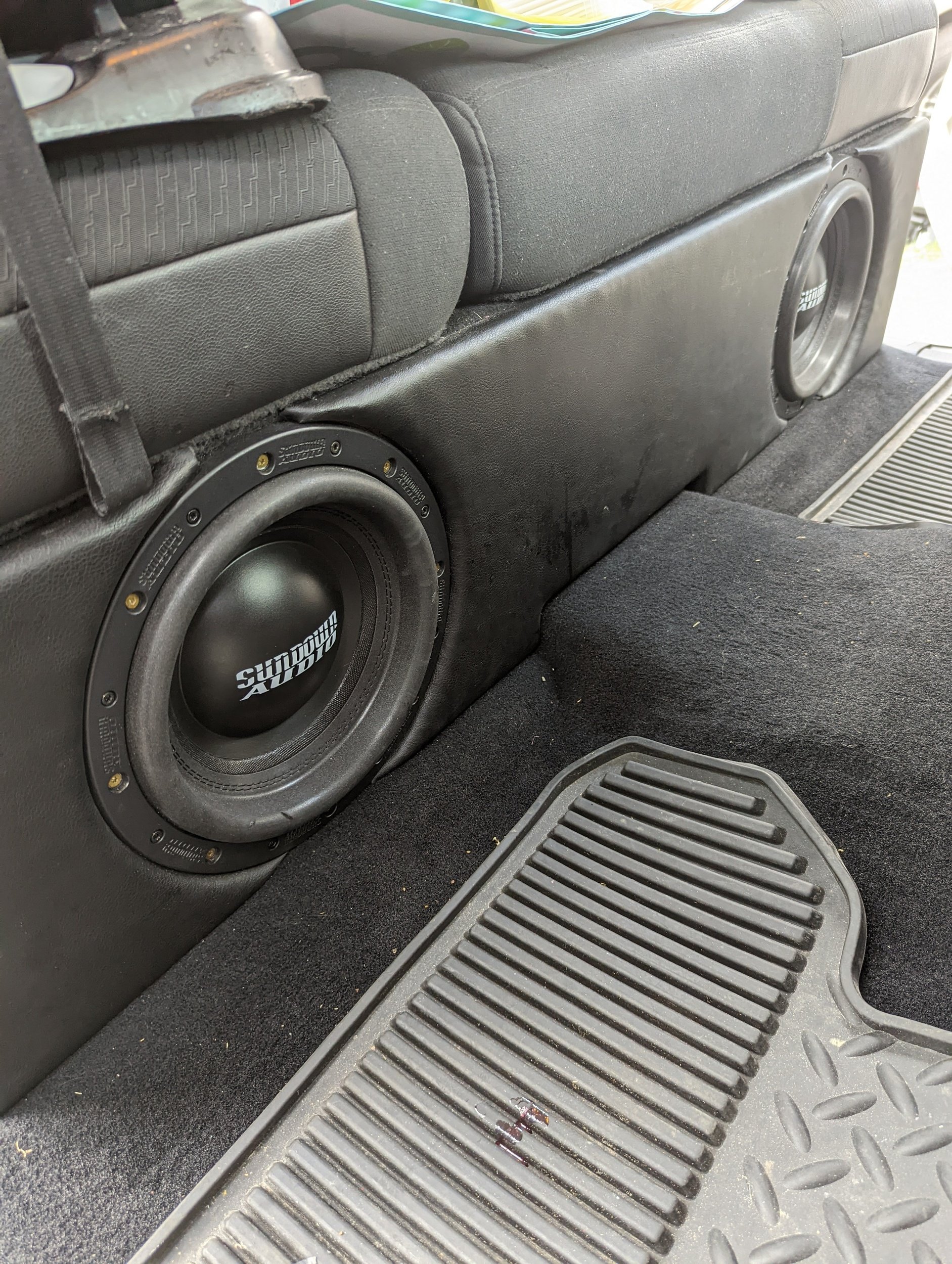

My (2) sa10v2 got damn loud on 1500 rated watts realistically closer to 2000w.
You could easily build a slightly larger box to gain efficiency. The 2.75inch voice coil of the sa v2 sure can hold more power but if you want to throw more I'd suggest just going ahead to the 3inch coil u series
You could easily build a slightly larger box to gain efficiency. The 2.75inch voice coil of the sa v2 sure can hold more power but if you want to throw more I'd suggest just going ahead to the 3inch coil u seriesView attachment 40948
